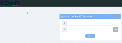

The ldap request with ldapsearch are ok with cn or sAMAcconutName, but the log attemps on the authentication portal (attachment) are impossible with the sAMAccountName.
I have tried various settings with ldapUserSearchAttribute and ldapUserNameAttribute (=> sAMAccountName) but without success, only attribute "cn" worlk well on the authentication portal. Even in the user list when we are logged in Dynfi, it's the "cn" that appears.
Sorry but I don't know if I'm clear in my explanation and I can't put confidential information in this post, but I remain available if you need further information.
Thanks for your help.
Regards
