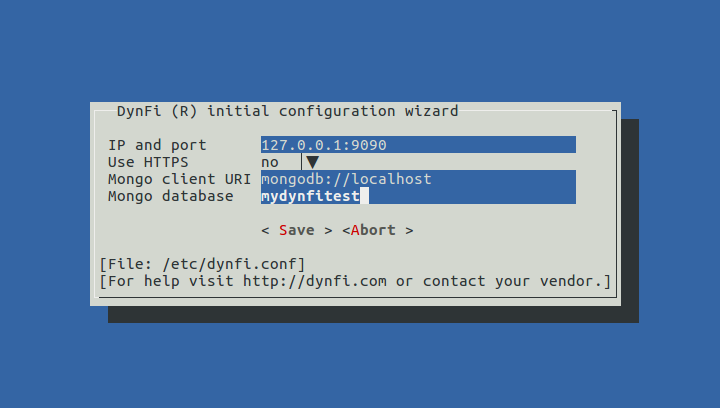

During the installation you will see a configuration wizard which will guide you through creating default config file /etc/dynfi.conf with basic settings. (Refer to DFM Configuration for more details.)
_images/configuration_wizard.png
Configuration wizard
Selecting <Save> button will finish the installation process and start DynFi Manager at selected IP and port.
If you do not see the wizard, then you do not have Java >= 11 installed properly.
