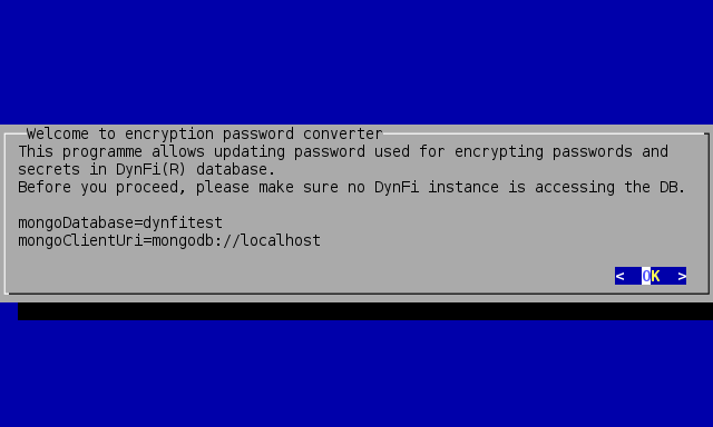

To migrate to new encryption password, stop DynFi Manager first. (It is advised to create database backup too.) Then run DynFi Manager’s encryption wizard to change or drop encryption password (you can also specify path to your custom configuration file if not using the default location):
java -jar /path/to/dynfi.jar changeEncryptionPassword [--config /path/to/my/custom_dynfi.conf]

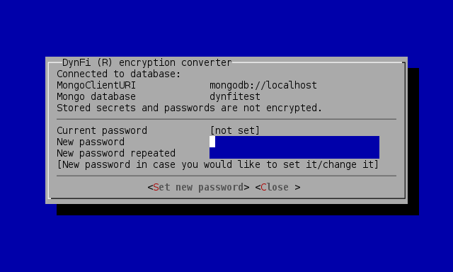

To navigate, use arrows and tab keys, select using [Enter] key. First, the wizard will inform which database is used:
In case of databases in which secrets are not encrypted, the wizard will only allow entering new password twice:

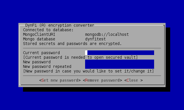

In case of databases in which secrets are already encrypted, the wizard will also require the current (old) password:

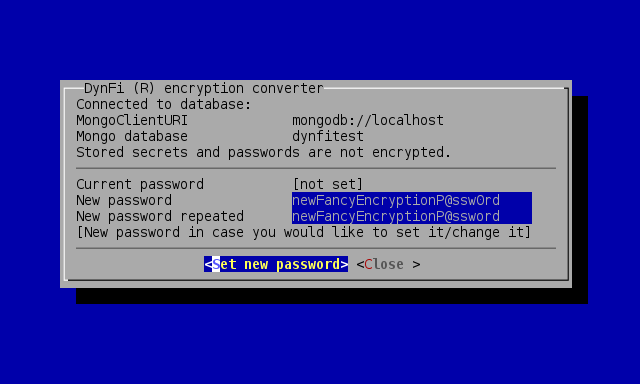

In order to set or update encryption password, enter the new encryption password twice and select <Set new password>:

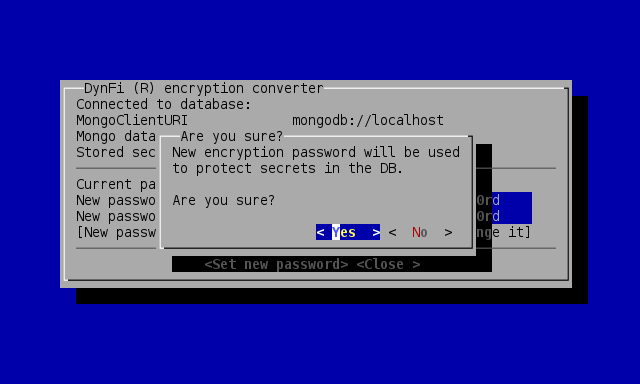

The conversion will not begin if not confirmed:

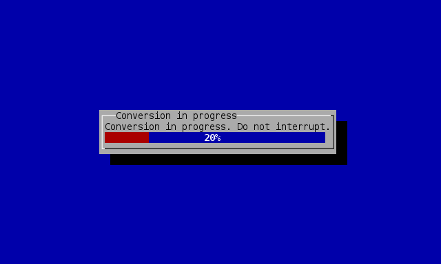

Next, progress can observed (if there are many secrets and conversion takes a while):

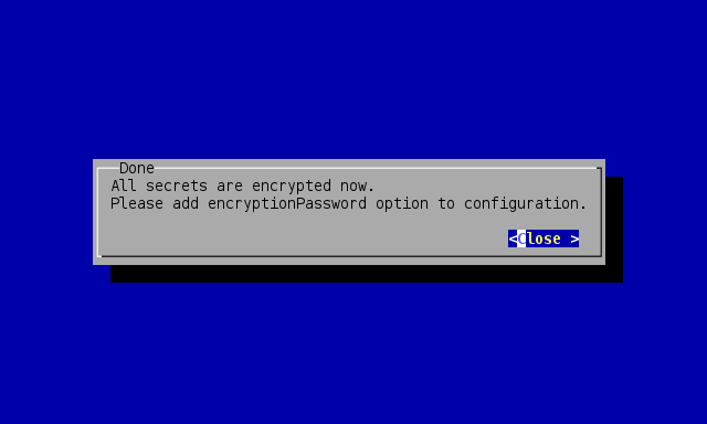

After completing the conversion, it is confirmed by the wizard.
Now the new encryptionPassword
has to be set in DynFi Manager’s configuration.
